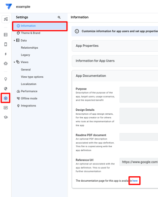

Please take a look at the documentation option under Settings.> Information --> App Documentation
You will get documentation on slices like below

thank you for your post! I know about that documentation feature and also that there you can find the definition of a slice. What I am missing is the information, in which views a slice is used. As you can see also on your printscreens, there is nowhere any information about the connections between slices (or tables) and views. I'd expect in the views definition some information about the used datasource... Here I can't find this:
