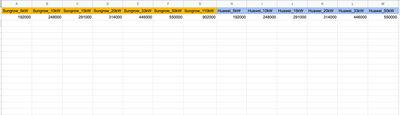

I've made another table with prices of inverters  like this:
What I want to do is to get The related price from the INVT table in the quotations table based on Dropdown inputs of "Inverter Company" and "Inverter Rating". Lets say user selects "Huawei" and "5kW". I've already added a virtual column to concatenate the required string for column search like this: CONCATENATE(TEXT([Inverter Company]),"_",TEXT([Inverter Rating])). Now I need to get the value of this column from INVT table. A help would be much appreciated. Any help would be much appreciated!

The Lookup or Select function has been the real problem for me. Before this Column structure I was using this structure:
But was stuck on how to query the inputs to get those values.
(LOOKUP([Inverter Company],"INVT","Company",[Inverter Rating]))
Tries this with error saying that [Inverter Rating] should be a string.

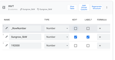

Thanks for your quick reply. I had first added my price list in rows:
but when I added the table in my data it looks like this:
This seemingly creates a problem for me which means I cannot make a form from this as I can edit my prices from the app because it just has two rows to work with.
You should put column header and dont make it number should be text in your 1st column.
