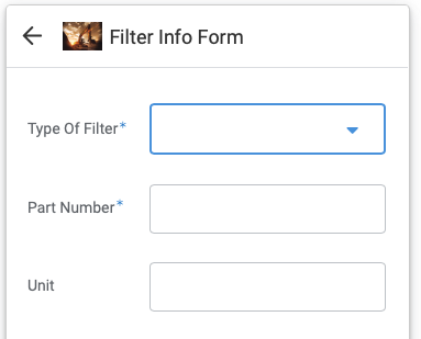

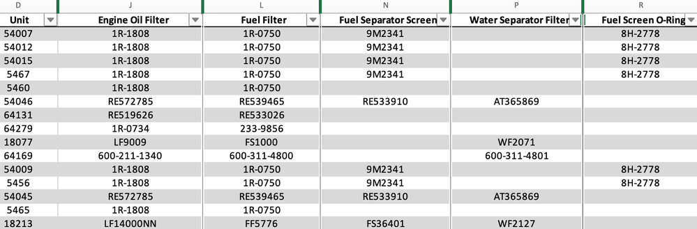

Thank you for your reply back. I have a master equipment list that breaks down what type of filter and their part number. In the master sheet the "type of filter" Eg Engine oil filter, Fuel filter. Hydraulic filter. Ect. Column list go on. I made it that way because of the many different type of filter are need for the that one equipment. Under each "type of filter" will have their one part number. Now some equipment could use that same filter.
The main equipment info page works great. I've be struggling on another section call filter info. On this page I have it set kind of set up to do the following, bare with me on this.
From Top to Bottom of the page.
Description:               Value Box:

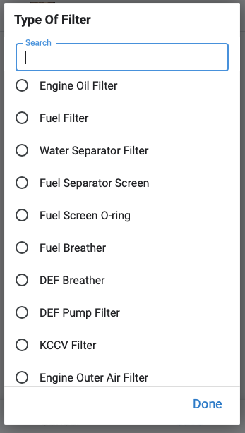

Type of Filter:             Engine Oil filter - This value with change on the type filter I want to lookup.
Part Number:             zz-2342 - this value with change also, as each part number different.
Unit(s):                         22,23,24,24 - this is where I like the value formula to show me what units use this "Type of Filter" once the part number is added.
I've try multiple ways that I can think of but it seems simple in my head, but not when I try to make a formula. Because "Type of Filter" box (Dropdown list of different filter) in the filter info page it's a column in the main equipment date. When I use [_thisrow} in a select formula it looks for a column name "Type of Filter" in the sheet.  If type only [_thisrow] it will show me the selected filter from the dropdown list.
So when I combine is a select value relationship Select(ledcor[unit], ( [_thisrow].[type of filter] = [Part Number].[type of filter]), false) it shows me all units even the ones that don't use that filter's part number.
Now if I use: Select(ledcor[unit], [part number] = [_thisrow]) I get nothing. but if I use Select(ledcor[unit], [part number] = [Engine Oil Filter])  it give me the proper equipment that uses this filter and it's part number. But when I pick a different type of filter like Fuel Filter is shows me nothing as this formal is only looking for "Engine oil Filter" so I'm have issue using [_thisrow] to as if by itself in its on spot tells me what type of filter is listed at the top of the page.
I've included screen shot of the main equipment data screenshot of area on my Appsheet.
