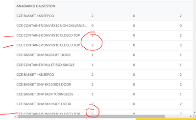

I have an app that has a table - "Dispatch_report_query".   In this table, items are listed by id.  I have columns such as Location and category and sub category.  I need to count or sum the items that have a"1" by them if they are "On Hand".  I can get the sum/count - but when I put this in a view - it shows that total number per each ID:
I don't need it shown 3 times.  But it does that because there are 3 assets (ID rows) in the table.  I just want to show that count once.

Its adding up the rows, But I need only the rows that have a "1" in the "On Hand" column:
So, now it does add up the rows - WITHOUT duplicating sub categories, however it is counting the row even if the item is NOT on hand.

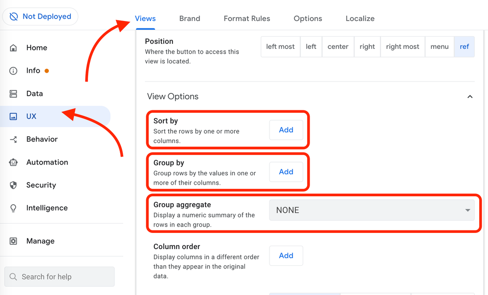

First did you consider using the grouping feature in your View? In your view settings you can group by the "Sub Category" and "Area" columns, and you'll be able to automatically display a count or a sum for your number columns.
You can additionally add grouping also by your "On hand" column, so for example, your first column to group by will be "On hand", also sort by this column in descending order so that you first see the records with "1"s, and the view will show you the count/sum. The second column to group by for example would be "Area", so that when you expand your first group, you'll see the count/sums per each area code, then comes the third columns to group with "Sub Category", so that when you expand each area you'll see the sub categories inside.

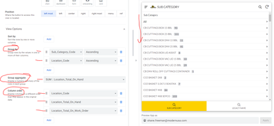

If you set your View as indicated, grouping first by Subcategory, then by Location, setting the Group aggregate as Sum of column "On hand", you'll get a view very similar to your report.
Have you tried it already?
If your aim is to have a printable report, then you can also have a similar result using templates.

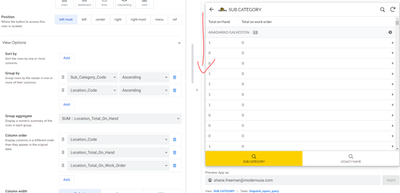

It almost works  - however.  See below for the difference.
Here is what it looks like:
If I click "All" then it gives me this:
But see how different it is from this?
I need BOTH total on hand and Total on work order - out to the side (like in this last pic)
