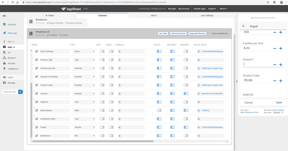

I tried a valid if formula, but it is just saying everything I enter is invalid even if the number is under the amount remaining. I am also unsure how to make the number of cases specific to the type of produce as well. So for instance. I want to have it tell me I ran out of potatoes specifically and when I enter apples as the product type it knows I have a specific quantity left. Here are a couple of screenshots of where i am.
