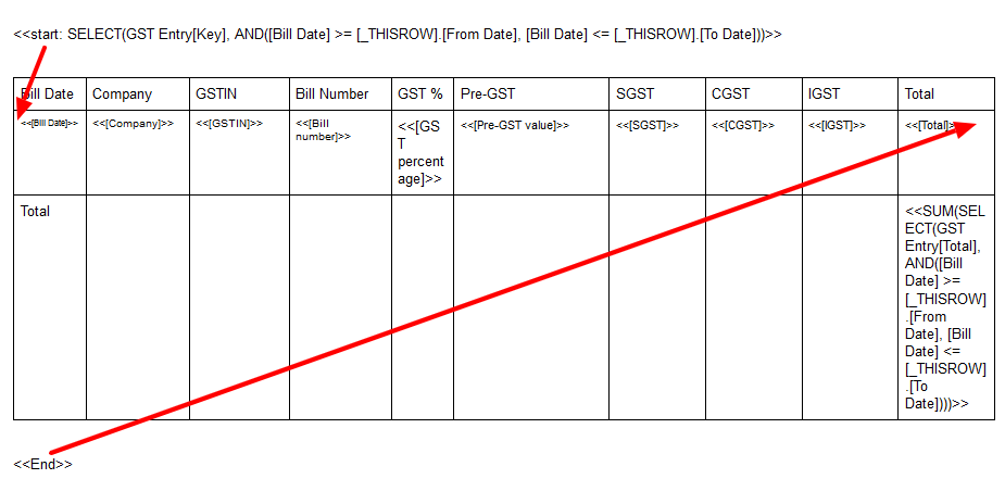

Iโ€™ve done most of it.
Thereโ€™s one thing I canโ€™t do right.
The above image is the format. I intend to keep the โ€˜Total of [Total]โ€™ in the bottom right cell. When the report comes through, it is a three row separate table collection of all the records from the slice, rather than a continuous table with the total column in the end.
How to fix this?
It comes like this:
Rather than a complete continuous table.
Move your <<Start>> and <<End>> tags:
