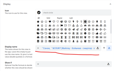

How to hide calculates display name at menu button?
Hello everyone!

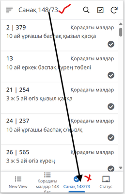

I have maked calculated display name. Its work great, but this name shows at menu button. How can I hide them, but show calculated name show at header of view?

Place your view with the calculated name inside of a dashboard type view, nesting them like this will allow you to have two separate names.
Hi @LLake ,
Would you please elaborate your approach.
Do you mean the name of the view that is displayed in the dashboard as highlighted in red in the screenshot below?
However the name in the header and primary view section as highlighted in yellow still continues to display together.
Maybe I am missing some obvious point that you have in mind.
That is as far as this work around will take you. The reference view name will display underneath the menu view name no matter what.
