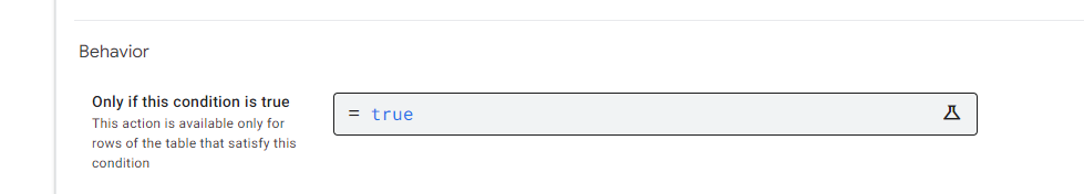

You can control the visibility of an action by setting
Use ,for instance, CONTEXT("VIEW") = "your view name", or whatever meets your requirements.

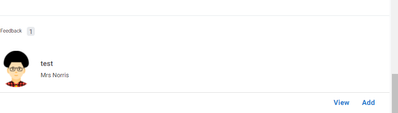

please find below screen shot for reference
How hide add action while viewing self profile, Add action should be visible while viewing others profile.
Make sure you display system generated actions.
You should see Add action
Create a read-only slice on the table. In the configuration for the column that contains the in-line view you want to hide the Add button, change the Reference Table setting to to slice rather than the table.
thanks Steve can you  please detailed it out
