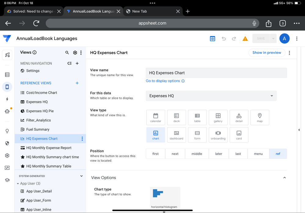

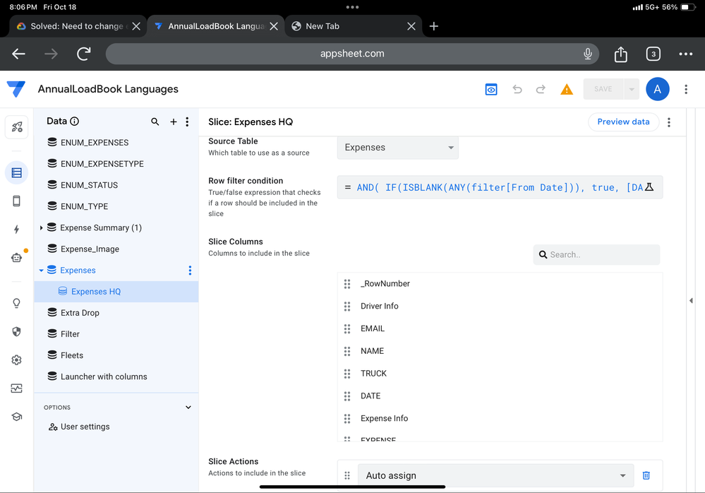

In the annualloadbook app the Language Change is working great except in one of the Reference  View. The data comes from the table {Expenses}, Slice {Expense HQ} The column that it uses from the slice is the Expense Column.

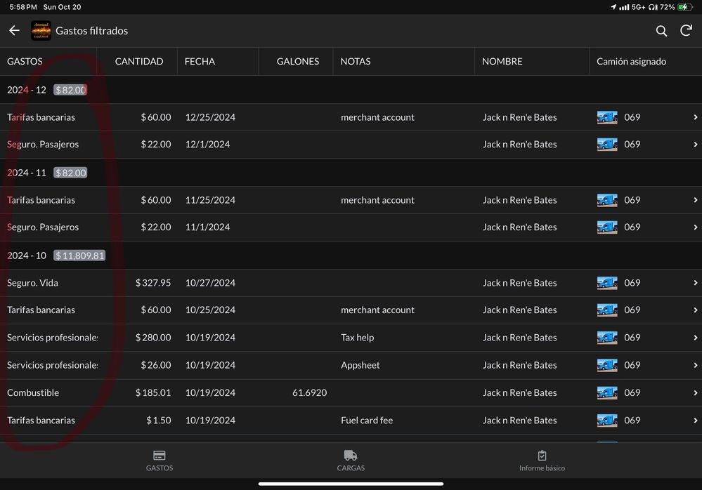

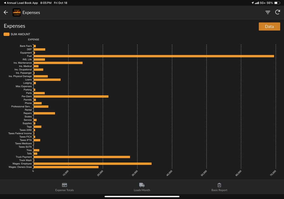

In the view for expenses the expense names do change language when the app user changes it. But not the names in the chart for the expense names.
The app view doesnโ€™t changeThe app view doesnโ€™t changeThe Ref viewThe Ref viewThe ref viewThe ref viewExpenses SliceExpenses SliceThe filter conditionThe filter conditionExpenses category totalsExpenses category totals

This is what the chart looks like and the DATA changes with the language selection but the chart doesnโ€™t change.
I have to use the slice to pull information from the Filter table so the user can set the perimeters for the dynamic analytics filters by the unit selected or the driver selected.

I would have to add an expression in the slice but it crashes error each
time I try so far

Using the switch statement changes the language on the overlay but not the chart catagories
