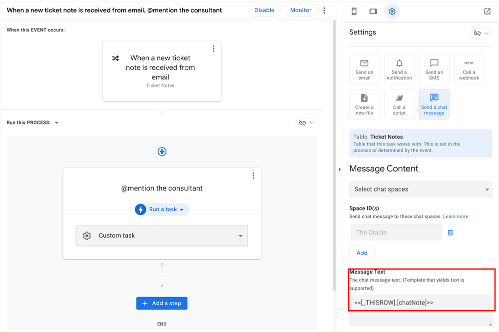

@Lapouge how are you including the user tag into the chat message?  We preformat the message in a LongText column called chatNote and then add the chatNote in the bot, e.g. here's the LongText
"<users/"&[Ticket].[Assigned To]&">
*"&[Status].[Name]&" - "&[displayTimestamp]&" by "&
IF(ISNOTBLANK([sender]), [senderName], [Consultant].[_ComputedName])
"&[Note]&
IF(
  ISNOTBLANK([groupUrl]),
<"&[groupUrl]&"|"&[subject]&">",
And here's what we include in the bot (outlined in red):
