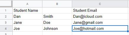

You have a Roster table that lists names and emails? Iโ€™ll assume so, and assume it looks like this:
Then you have a sheet with a Text/LongText type column in which youโ€™ve manually written in Roster names, separate by commas?

Hello Marc,
Thank you for your assistance.
I like the idea of the enumlist. Will I still be able to select multiple students from that list? Sometimes I could have up to 23 students assigned to various tasks.
Here is a screenshot of a sample data table I am working with.(Hopefully this is visible)
