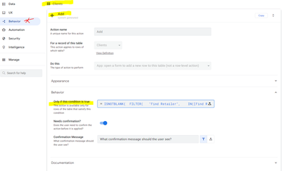

So I have tried to use the "Only if this condition is true" in the Add action for the relevant table - problem is, the app creates records every time. It does not appear to validate the condition. What am I missing?

Here is the conditional expression I am using for the Add action of the Clients table (the table with the job request details):
ISNOTBLANK(
  FILTER(
   "Find Retailer",
    IN([_THISROW].[Find Retailer Code], LIST([Found Retailer Name]))
  - LIST([_THISROW])

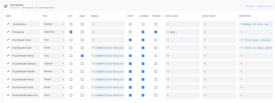

I've included some screenshots of my tables below:
Clients (details about the Install Job Request)
Retailers (details of the sales reps)
Find Retailer (intermediary table for looking up the Retailer codes and Sales Rep details)

Thanks Joseph, have read the article in its entirety, I already have a basic understanding of the concepts described. But before I rebuild my datasets from the ground up, what I am failing to understand is why a record in the Clients table is created every time, regardless of whether the condition is true or false - my expression is no doubt wrong.
On the New Install view, a rep will enter a Retail Code - if found, the Retailer Name, Mobile and Email fields are filled with the corresponding data - ergo, these files are not blank, thus when Save is pressed, create a record for the job in the Clients table.
If the Retailer Code is not found, surely Retailer Name, Mobile and Email form fields are blank, thus a record should not be created:
Furthermore, despite having "Needs confirmation" turned on, I never get any alert requesting confirmation of the Add behaviour.
I didn't think that achieving this would be particularly complicated - if the Retailer Name is not found due to an invalid Retailer Code not being matched in the Retailers table, then don't Add a new record in the Clients table. Why can't this be done? What expression would result in the condition being false?
I fully understand what you are trying to do, and for this Iโ€™m telling you that you should build references among your tables, and it will be just a matter of correctly setting the type of relevant columns, not โ€œrebuilding the database from the ground upโ€.
Once you have this, it will be easy to achieve the desired behavior through your columnsโ€™ Valid if fields. Youโ€™ve misunderstood how the behavior action works, so your expression makes no sense.
