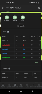

heres an examp of mine with 5 different reference rows that use [team] as the filter.
โ€ƒ
โ€ƒ
โ€ƒ
โ€ƒ

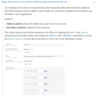

Is it possible to ref a value entered in a form view?
I have other table where i fill the form page if I need to add/remove something from my stock.
for example if i remove 10 pieces of a product, can i copy over that quantity "10" via action to another table?
Hi @Krismar
Yes
@Aurelien wrote:
References between tables - AppSheet Help
Dereference expressions - AppSheet Help
You can achieve that using an action:
Actions: The Essentials - AppSheet Help
