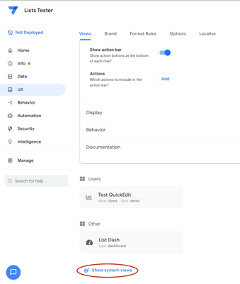

  3. If the View doesn't seem to open then you may need to show the system views.  Scroll all the way down the view list while in the View panel and tap the "Show system views" button.  See image

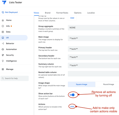

     4. Once in the"Related Deliverys_Inline" view, scroll down to find the Actions property. You can control what actions are shown in the view by the properties indicated in the image below.
