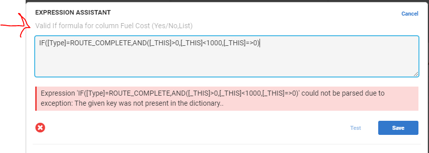

Iโ€™m trying to run the following Valid IF but Iโ€™m getting the error below:
If the type field is ROUTE COMPLETE, then the Fuel Cost field is valid if its >0 but less than 1000. The field could otherwise be 0 or >0 but less than 1000.

You may wish to try below
OR(
AND([Type]=ROUTE_COMPLETE, [_THIS]>0, [_THIS]<1000),
AND([_THIS]>=0, [_THIS]<1000)
Thank you Suvrutt, this worked perfectly!
There is no => operator, which renders this expression invalid.
Good catch @Steve.
Got it. Very helpful. Thanks Steve
Just checking, => is invalid but >= works, correct?
I use >= all over the place in my app.
Yes youโ€™re right. Greater/Less than symbol before equal symbol is the correct format;)
Yes.
