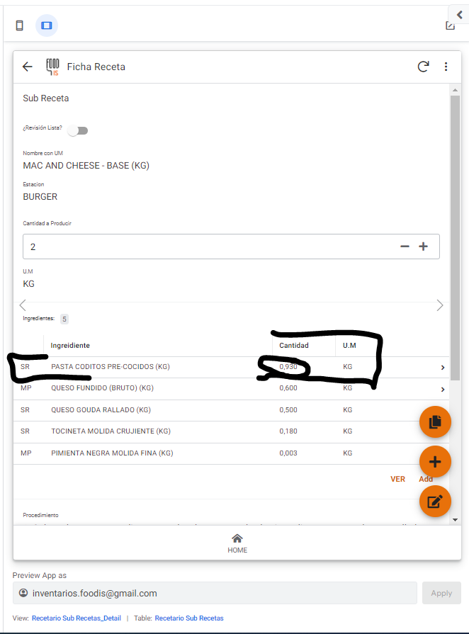

In the first image is the detail view where the recipe information is, in the case that it is a sub-recipe (SR) when I click on the inline of the reference I want it to take me to the detail view of that referenced sub-recipe and since that view has a quick edit, its Production Yield column is edited automatically with the value of the quantity in the referenced inline of the ingredients.
Image 1:
Image 2:
the production yield value is the one I would like to be automatically edited once I travel from one view to another.

Ok, this is much more clear.
I still donโ€™t quite understand this part. Isnโ€™t the โ€œCantidadโ€ column from the table and the โ€œCantidad a Producirโ€ column in the Detail view the same column? If so there is no need to make an update. If not, then the update should be done to both at the same time when the original โ€œCantidadโ€ value was set/updated - so they stay in sync at all times.
