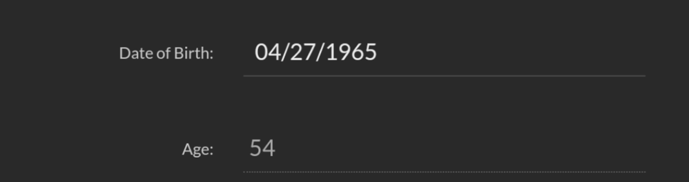

This contact is now showing the correct age. I started out with the date 4/27/1965. This correctly calculates the age of 54. I then tried to update the date in the spreadsheet to 4/27/1966 to see what would happen after a sync. It correctly updated to 53.

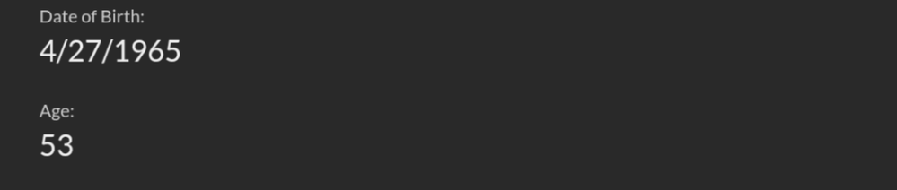

Iโ€™m at a loss because one of my real contactโ€™s date of birth is 4/27/1965 and a few days ago this should have automatically updated to 54, but it still remains at 53 unless I edit the entry. Please see the detail view and the form view below:

@Guillermo_Perez It would help to find out the reason if your app could be in that stage where the age is wrong after syncing. When you see that behavior, donโ€™t open and save that record so it wonโ€™t change anything. When your app is in that stage, send an email to support@appsheet.com with details and we will debug the reason. For now itโ€™s difficult because your app is not in that stage.
