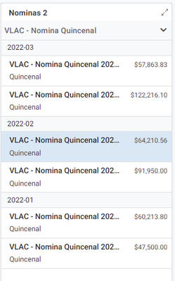

This worked almost to my total satisfaction, sooo close. The tables and views all get populated correctly and it all works like I wanted it to. But there's one little UX thing that I guess can't be dealt with: The selected row on the First Table that has the action to filter the rest of the views in the Dashboard does not stay visually selected. Here's an image of how it stays selected using regular Interactive Dashboard:
But using your method, everything works great but the row won't get highlighted like that.
Now I can't decide what I can tolerate more, the Detail Views with the Inline tables of different sizes or the Rows selected not getting highlighted...

you can try using Format rules to highlight a selected row.
Yes. I'm currently playing around with format rules.
