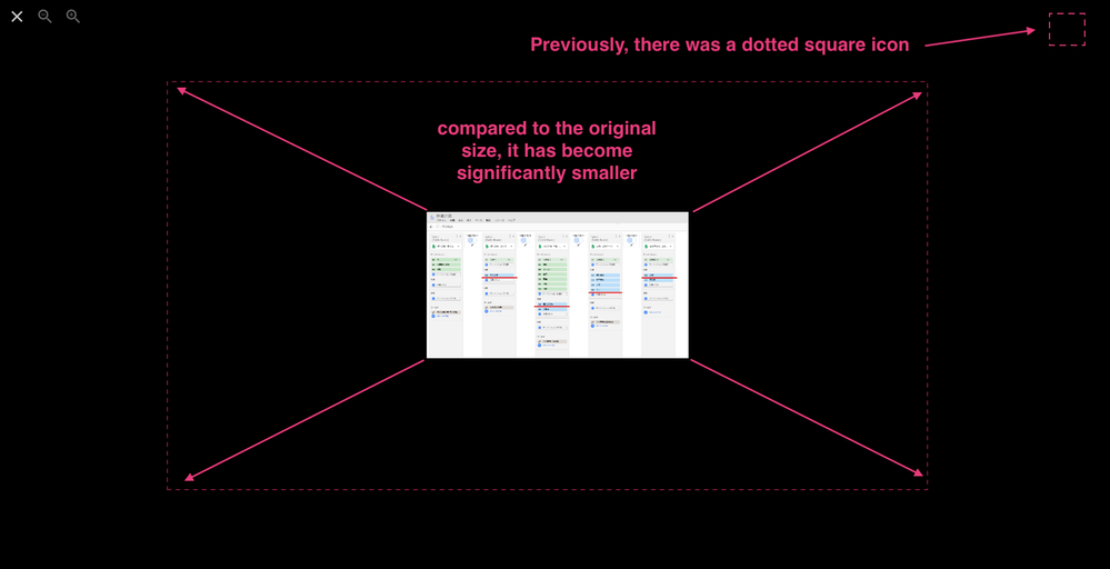

I'm having an issue where photos uploaded from an Image Type Column are displaying at a reduced size.
The attached screenshot is from Looker Studio data integration, and compared to the original size, it has become significantly smaller and is barely visible.
Previously, there was a dotted square icon in the top right corner that, when clicked, would display the image at the same size as the original screenshot.
Currently, there's a zoom icon in the top left corner, but it ignores the original size, making it meaningless.
Could you please restore it to the previous state?

I uploaded the Looker Studio screenshots to AppSheet with the "Image upload size" set to "Full". Previously, I could click the square icon in the top right to display them at full size in AppSheet. Of course, I could also read the text within them.
All images previously uploaded at Full size are now similarly displayed in reduced size. Before, I could use the square icon in the top right to view them at full size.
Speculating on the Cause
Currently, it appears the square icon in the top right has been removed, replaced by a zoom control in the top left. My guess is that this top-left control is not properly retrieving the image size. Related to this, when displaying an image in AppSheet and right-clicking to "Save image as...", you can download the original full-size image. This suggests the top-left control is not functioning correctly.

Based on these results, I suspect the new image display control library is not functioning correctly. The previous square icon in the top right could display images according to their actual size.
Could the development team please investigate this issue and, if they recognize the problem, implement a fix promptly?
