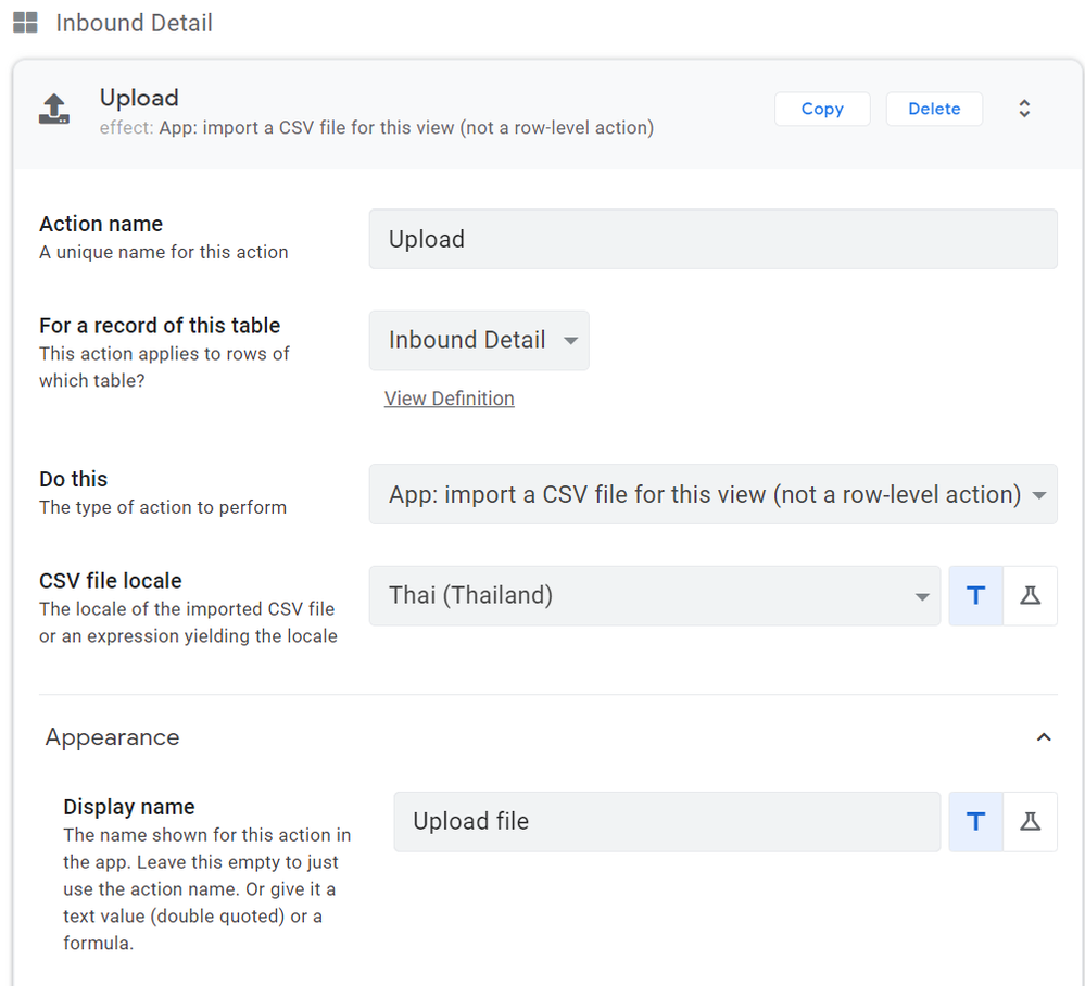

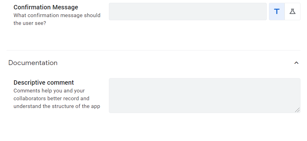

Please post a screenshot of the entire configuration of the action that is trying to create the row.
Hi Steve,
My action to create the new row as show below.
Is there any points that i should recheck ?
Remove that field from the CSV file.
Thank you very much Grant_Stead ! It’s working !!!
