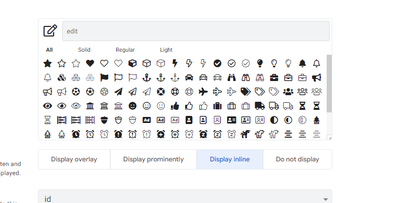

What ever action displayed should have the below setup.
Change it to "Do Not Display"
It's the System generated action though - that is the grey right angle icon.  I don't see any settings for that.
It does not matter if an action is System Gen'd.
Okay, thanks. I couldn't see where system actions were. So I reread the appsheet article - https://help.appsheet.com/en/articles/1013324-system-actions
So for anyone else coming across this similar issue, this is how to find it. When you are in the behaviour > actions, at the very bottom of the screen there is two buttons, one for rearrange actions and one for show system actions. Then once they Show, you can set the Prominence that @TeeSee1 highlighted in his reply.
