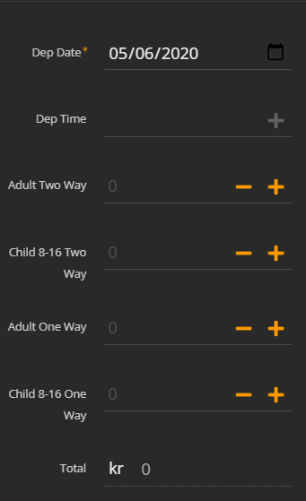

If it helps, here is the interface the driver will see - you can see more clearly why it will be handy for the driver to have the Departure Time preset as the groups board. Perhaps there’s another way?
Is the column [Dep Time] of type TIME ? The above mentioned expressions should work if the [Dep Time] column is TIME type.
