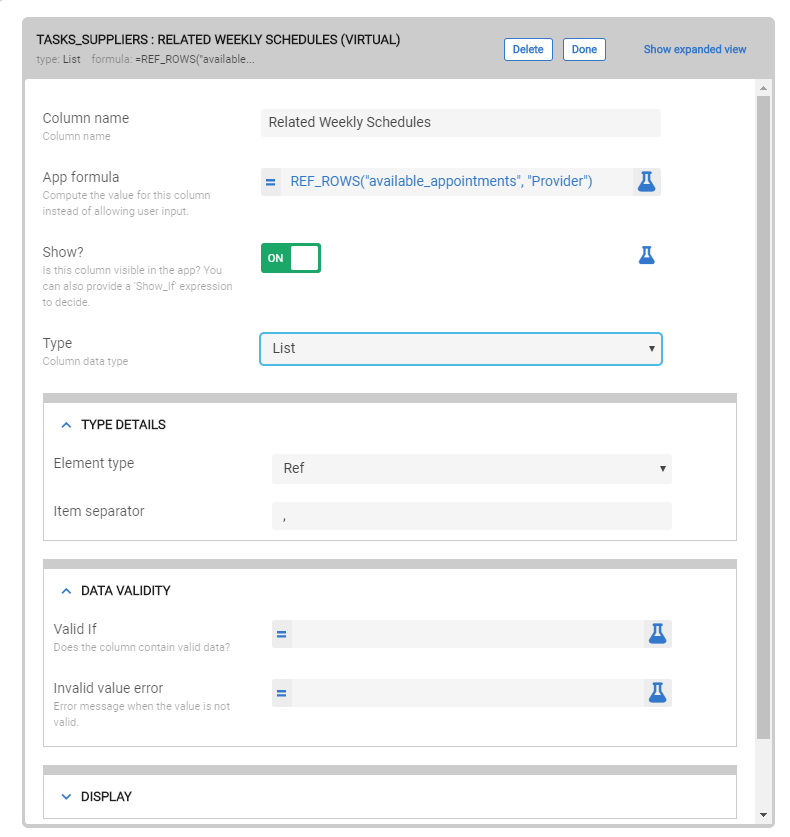

I have an inline table view based on a parent/child relationship (child table “Weekly Schedule” is linked to parent table “tasks_suppliers” via REF field called Provider).
I’ve created a slice called available_appointments based on the Weekly Schedule table (for only “Open” appointments) so I’d like the underlying data for the child inline views to represent this data vs. the Weekly Schedule table data. To do this, I simply updated the REF_ROWS to reflect the “available_appointments” slice.
Problem: When I use the view and click on one of the options it takes me to the Weekly Schedules table view and not the view for available_appointments as expected. Note: When I click on the View option at the bottom of the inline view listing and then select my option, it DOES follow the appropriate view path for the available_appointments slice.
I also created a new virtual column and added the appropriate REF_ROWS expression to the app formula but no luck. What’s causing it to revert to the Weekly Schedules table and not follow the view path for the available_appointments slice?
