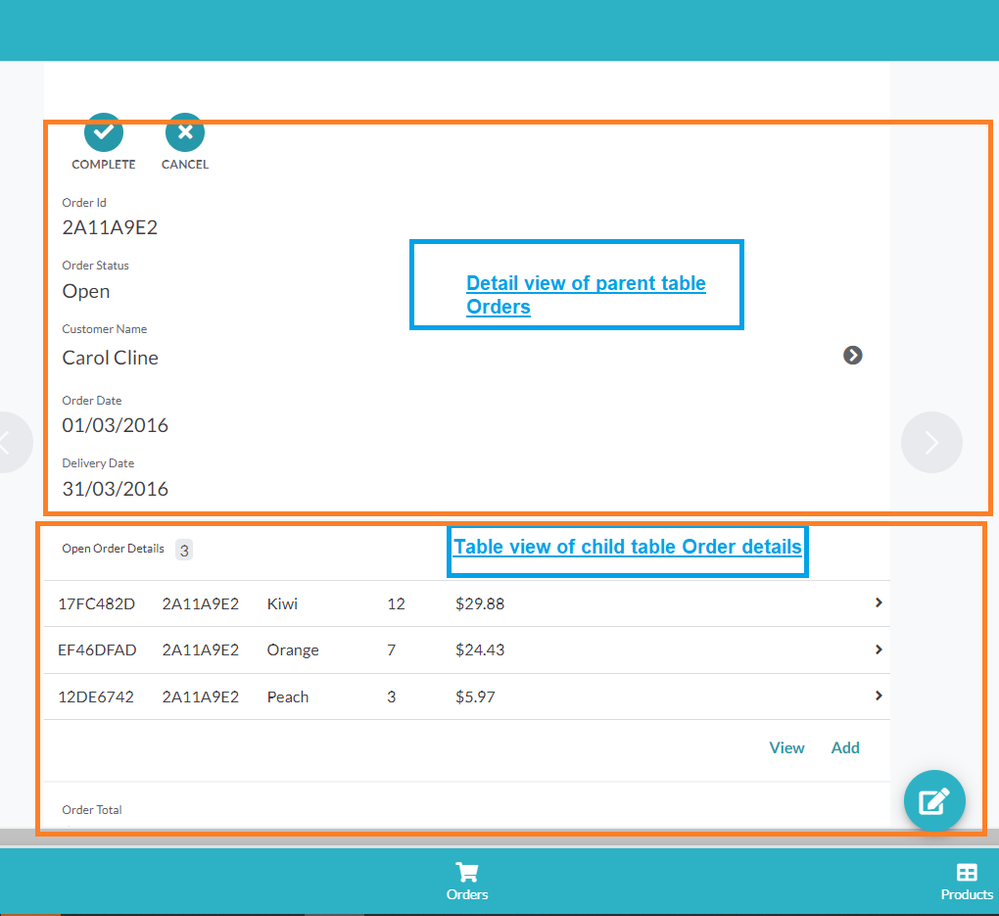

Showing  child table data in detail view of parent table is a standard configuration in Appsheet. Please explore if referencing between table works for you. There are many sample apps where you could find how it works.
please take a look at the Order Capture sample app referred below from the article Feature Sample Apps
Order Capture Sample App
The Orders and Order details are parent child  tables in the app. The detail view of Orders displays Order details records  of the child table as  shown below.
