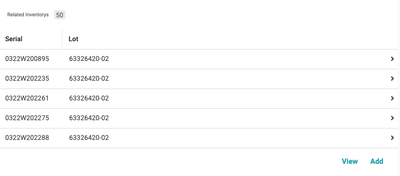

I am looking to hide product that is already sold and only displays available items depending on if there is a value in a column.
This is the view of my app displaying all the products

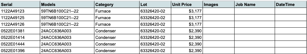

And here is the data source
If there is a value in the "Job Name" column, I would like that row not to display in the previous screenshot.

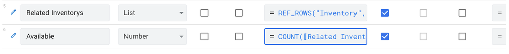

For the availability column I have it set up like this:
So the goal is when something is sold, I would like to remove it from the inline view along with the inventory amount going down. I am not sure what would be the simplest method on doing so.
