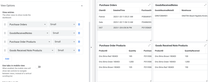

This is the Dashboard view

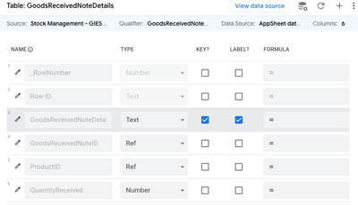

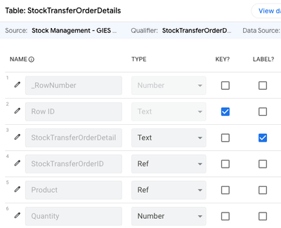

Below are the tables:

So I see you do have Interactive mode turned on for the Dashboard.  But you don't want to use the "Inline" views - those are specialized views for use inside of Detail and Form views.  Instead, create normal Table views and place those in the Dashboard.  AppSheet will take care of the rest.
The relationship between the StockTransferOrder and StockTransferOrderDetails tables looks great and should work right away.

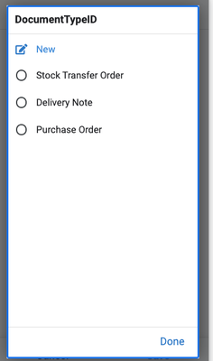

I did not know how to manage refs from multiple tables so in the GoodsReceivedNotes table, I created 2 fields: a dropdown name SourceDocumentType and a dependant dropdown Enum that lists the IDs of the selected Document Type. In the table, GoodsReceivedNotes that number is stored as plain text.
That is why there is no physical link between the table GoodsReceivedNotes and the tables StockTransferOrders / DeliveryNotes.
Is there a more elegant way achieve that goal?
Below is a screenshot of the table GoodsReceivedNotes showing the DocumentTypeID and SourceDocumentID fields
Below are screenshots of the case of GoodsReceivedNotes from a StockTransferOrder:
Below are screenshots of the case of GoodsReceivedNotes from a PurchaseOrder:
As I understand it, your Document Notes table could have been created based on entries in multiple source tables.   So your "Source Document ID" column if of Text type and NOT Ref.
However, If you wish for the Interactive Mode to work in the Dashboard, the column MUST be of Ref type.
What I recommend then, is instead of having a single column to store all source ID's, have a separate column for each one.  Then Modify your view to show only the column indicated in the "DocumentTypeID" column.

Hi @WillowMobileSys
I was afraid you would say that ๐Ÿ˜…. I have indeed created additional columns and did the show/hide of the fields, it is not as elegant as I wished but I guess it is the best we can do with the platform at the moment.
About the side note: Thank you for the advice; I have changed every Key to  RowID.
For the Interactive Dashboard, I added a VC in each Details tables that link back to the source document, this way when I click on a PurchaseOrder or a StockTransferOrder, the related GoodsReceivedNoteDetails Product appear. And I created slices of PurchaseOrderDetails and GoodsReceivedNotesDetails to show the relevant Product names and quantities.
Below is the result: I select a PurchaseOrder and I get the GoodsRececivedNote on the right and below I get side by side the products in each of their Details tables which is exactly what I wanted to do. I will do the same for the StockTransferOrders.connex91_1-1738093843430.png
