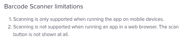

These are brand new ipads (generation 8 maybe? ) not sureโ€ฆwe are using the browser link on the ipads - does that matter. It was easier to create a qr code with browser link than trying to get the app installed since we donโ€™t have itunes logins for all 65+ ipads.
Yes. As far as I know, at the moment, you cannot scan from the browser โ€œout of the AppSheet boxโ€. I think I remember reading that others in the past were able to setup third-party scanning devices to work with AppSheet - usage from a desktop. I think the same applies to a tablet running in browser mode. Itโ€™s likely possible but requires additional hardware, software, etc to get it to work.
