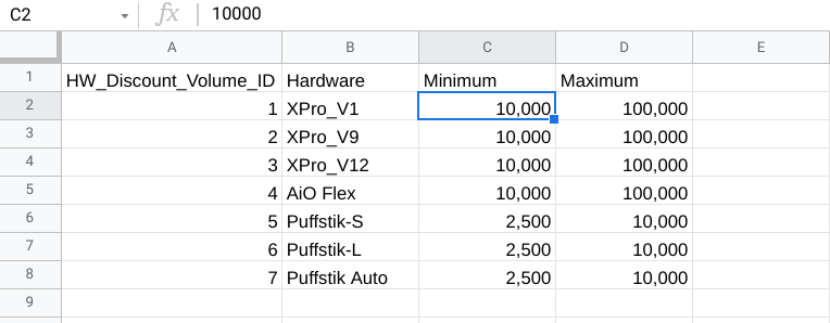

So I have been trying to change the range of the number data type. I changed it manually at first, but as you can see with the table below, the hardwares donโ€™t have the same limit.
Table Name: Hardware Discount
Hardware Minimum Maximum
Hardware#1 10,000 100,000
Hardware#2 10,000 100,000
Hardware#3 2,500 10,000

I have a bunch of tables. Quotes, Hardware, Pricing, Hardware Discount.
This expression would be used for Quotes. The pricing depends on the hardware discount. The hardware discount depends on the hardware.

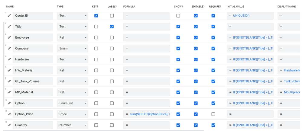

Would this help? Do you need other tables?
I could use a screenshot of your columns as seen from appsheetโ€™s app editor of both your Hardware Discount and Quotes tables
I have no idea on which column of your Quotes table youโ€™re gonna type in your desired discount, but you can use this expression on its valid_if() expression:
