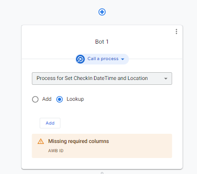

@MultiTech I made the 2 processes resusable, created a Master Bot and added those 2 processes in each step in the order shown here. AppSheet 2.png
I have some questions.
I got this.

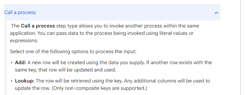

I looked for information about this and this is what I found.
When I save, I see no errors or warnings, so I guess that completion of the "Add" and "Lookup" is optional.  What else do I have to do here?
You'll want to do the "Lookup" option
  • This will then ask you what columns to use for the lookup.
  • The easiest way is to select the ID column for that table.
  • And for the value for that ID column, enter the ID column again `[Your_Id_Column]`
This essentially says to the system:
  • Run "this" process on "this" record
  • With the ID value you enter determining which record is processed.
I did it.
Now I have 3 bots: Bot 1, Bot 2 and the Master Bot.
The Master Bot is the only one that must work. If all 3 bots are enabled, how do I tell it to AppSheet? Do I have to disable Bot 1 and Bot 2?
