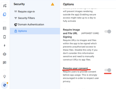

The AppSheet Support Team has contacted me and I am sharing this with you.
After taking this action, SNAPSHOT did indeed work, but SNAPSHOT used to work even when “Require user consent” was turned on.
We would like to have this corrected so that it works as it did before.
