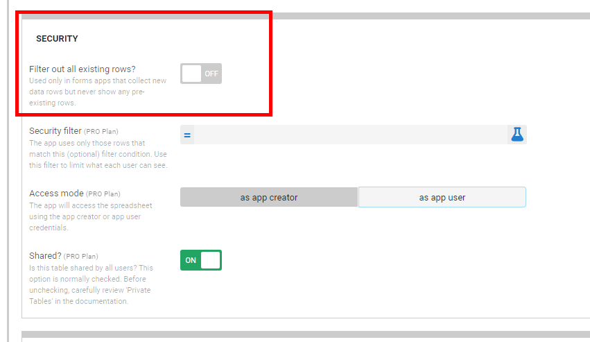

how do you restrict users to their own data after they click โ€œSave/Submitโ€?
Obviously the one Form app is a public app with no security filters (its an enquiry / survey)
@David_Joyce
With public apps all app data can be filtered out so that no any data can be seen. For the workflows only you have an option to bypass the security filters otherwise no any data can be retrieved from the source table. You can see that filtering option under the Security tab of your tableโ€™s details.
