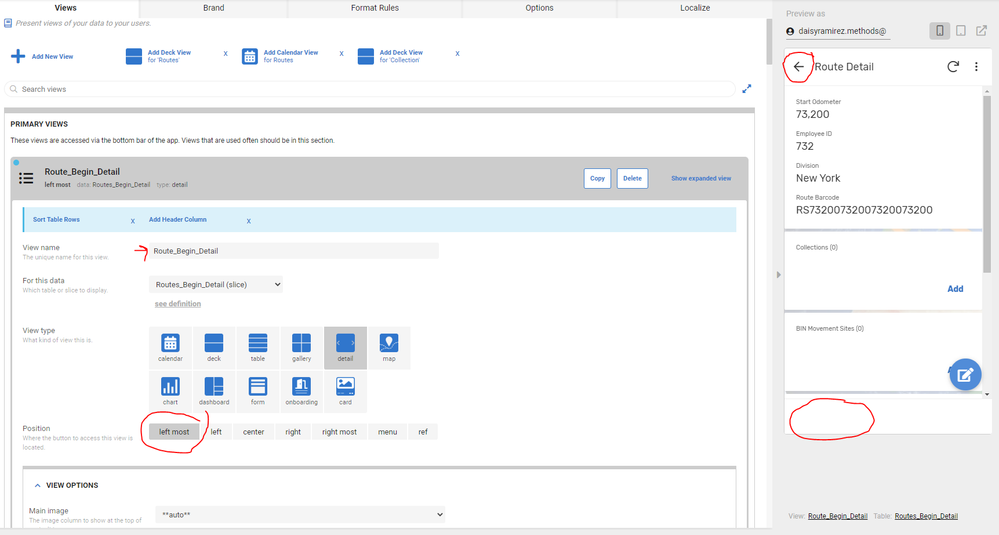

Hi Dave, just wanted to make sure I didn’t miss anything here. I placed the form on the bottom menu to make it a “primary” view and hid the view but I’m still getting the back arrow. We simply want to make it a free-standing form and not include it in the standard navigation sequence. Is there another setting missed? .
Bahbus
Ah. Nope, seems like you did it right. But it also seems like AppSheet is too smart. It must know that it’s still hidden and therefore should show the back button.

Hi Fabian, I ended up “hiding” the Cancel button and displaying it only on the screens where its appropriate. Here’s the expression I have in place:
IFS(
CONTEXT(View)=“Route_Begin”," “,
CONTEXT(View)=“Route_Collection”,” “,
CONTEXT(View)=“BIN_Move_Site”,” “,
CONTEXT(View)=“BIN Move Activity”,” ",
TRUE,“Cancel”)
The Cancel option is still there so if a user presses anywhere in the area they can access it but we have not had any issues. Fingers crossed it stays that way
See where I’ve set this up below:
