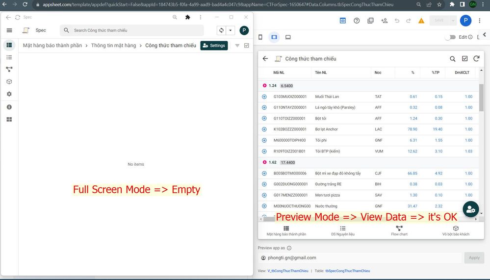

Hello AppSheet community,
I'm currently experiencing an issue with data loading in full-screen view when running my application.
Specifically, when I execute a Bot to retrieve data automatically (approximately 10 - 50 rows, 10 columns), I've tried both cases where the Bot triggers an action or calls a Webhook. The Bot execution is successful, but when I go to review the result data, it doesn't load (even though my application is in fast sync mode, and I've tried syncing multiple times and even refreshing the application's web page), the data still doesn't load. It takes several minutes for the data to load successfully in full-screen view.

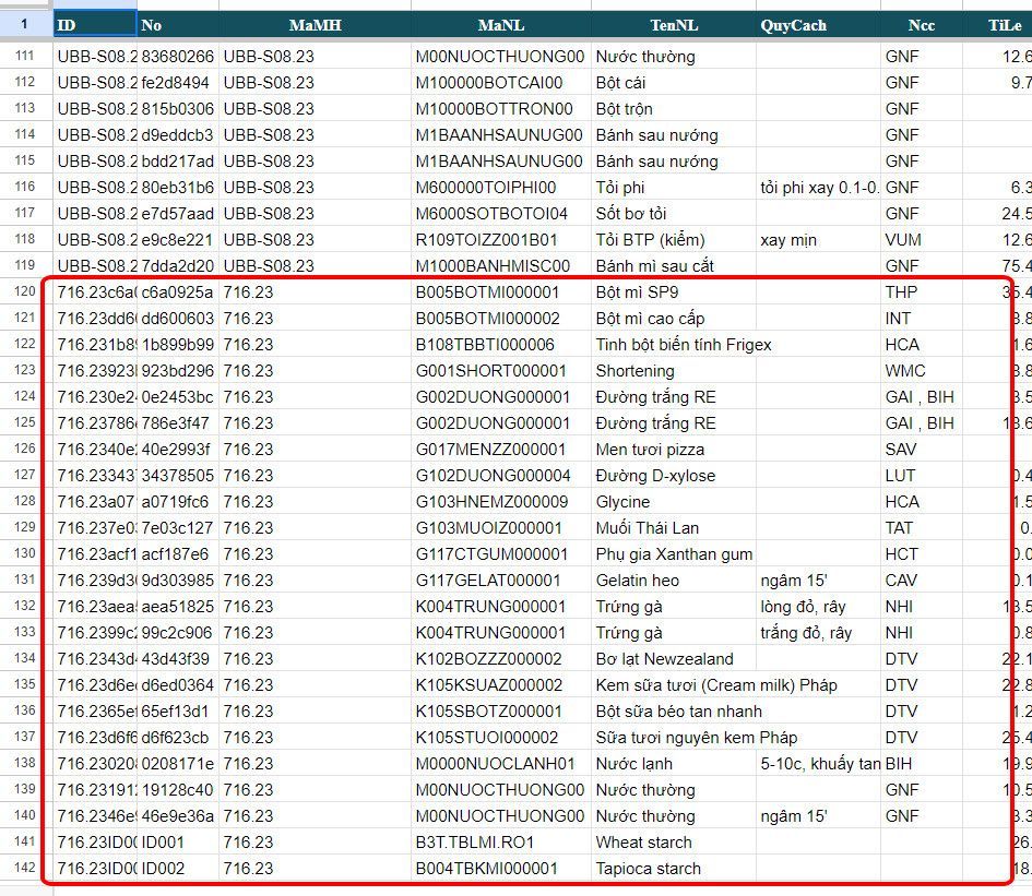

At the same time, I've checked the data source in Google Sheets and in the editor's preview mode, and everything appears to be working well (as shown in the attached images).
Has anyone encountered a similar issue, or does anyone have any suggestions on how to address this?
Thank you very much.
z4800464651331_04786ab0bfe44244bfb8115a858a2fbc.jpgz4800464672937_a5932a3f18fdc8a5fe8d996e8dfe9766.jpg

Both methods successfully add data to another table as I intended. However, the difference and the issue I'm facing are as follows:
  • When I operate in the preview mode within the app editor, the data is synchronized immediately after the Bots complete their execution.
  • When I operate in full-screen view (desktop view), the data doesn't synchronize immediately, even though I've clicked the sync button multiple times and refreshed the web page.
The delay in data synchronization in full-screen view (desktop view) is the issue I'm currently experiencing (My application is set to Quick Sync).
