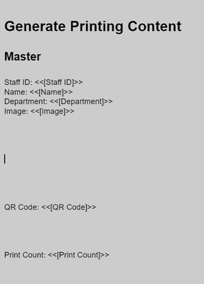

The template-generated URL is truncated. Please check the expression inside your template, or just replace it with the value of your image column, instead of repeating the formula.
Hi Joseph,
Below is my column type along with the value.
and below is my template:
is something wrong with it?

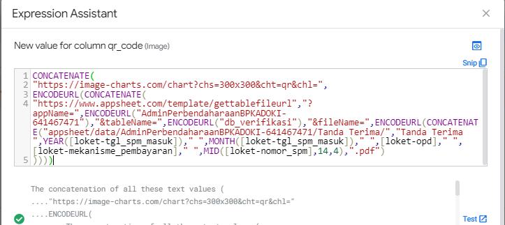

same case, not work in my work when QR cannot complately genereted to PDfmy syntax i guest this syntax is right but QR cannot complately generated in PDFmy syntax i guest this syntax is right but QR cannot complately generated in PDF
You shouldn't be using nested encodeurl()s, that'll cause issues. Just use one for the entire url string.
