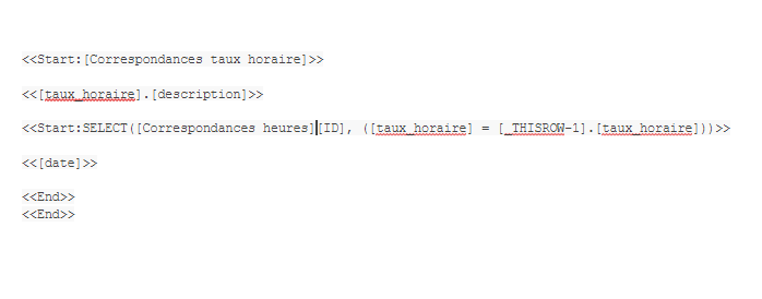

template:
<<Start:[corresponding employees]>>
<<Start:SELECT([corresponding logs][ID], ([employee] = [_THISROW-1].[employee]))>>
<<End>>
<<End>>

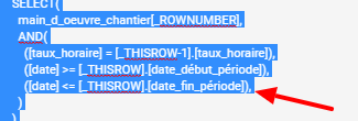

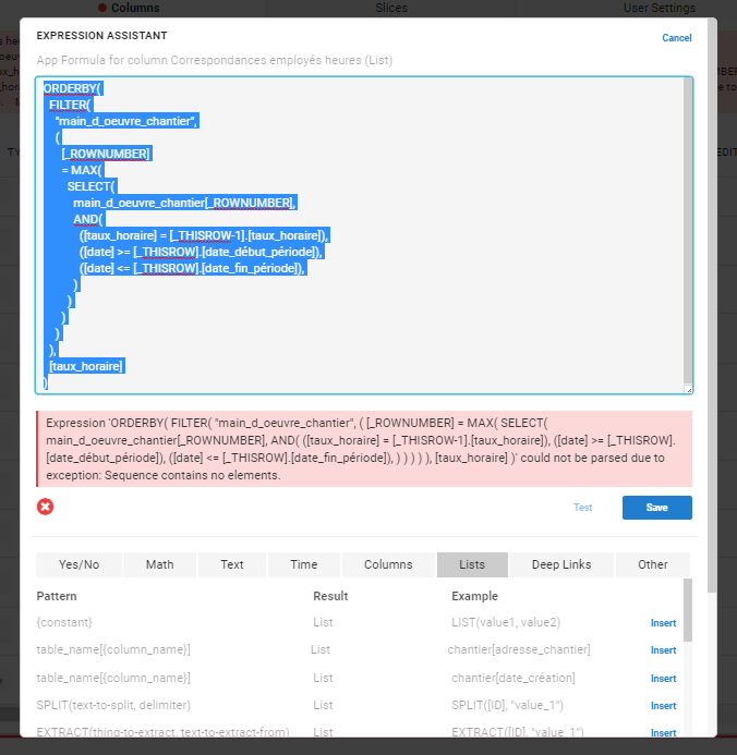

Thanks a lot looks promising. The corressponding employee expression fails :
The other one looks fine.
Whoops! My bad! Remove this comma:
Also fixed my previous post.
Hi @Steve
I got the point about comparing logs with logs within a single start expression. The corresponding employee expression returning one unique log key for each employee.
The report arrives but still something wrong even if both formula selection formula look fine.
The testing model looks clear too
But the report seems to ignore the second part of it
Can’t find out what’s wrong !
