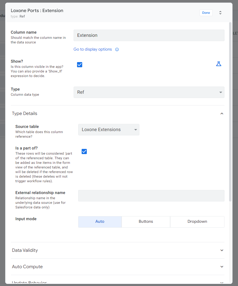

Can you provide a screenshot of your table's data structures so we can see how you have them linked?
Thanks, see below...
Ports Column referencing the ExtensionsPorts Column referencing the ExtensionsPortsPortsExtensionsExtensions
Try:
SELECT(Loxone Parts[Port Name],[Extension]=[_THISROW].[Extension Name])
..thanks, but this doesn't work - it doesn't throw an error or anything, it just doesn't do anything to the referenced table. I tried this initially, and after being frustrated I cut it right back to the hard-coded expression in my OP, where I'm just trying to select a row with a specific name (which also doesn't work).
I ran across a similar problem recently and ended up reporting it as a bug.  I also contacted support and for the past few days, I've been getting notifications that they are playing with my app, but they haven't told me anything yet.  You might want to try to create the most literal values possible by copying your key field values into a List() function for your referenced rows.  If that fails (as it does with my issue) then you know you're experiencing the same bug as me and you can stop assuming it's a problem with your formula.
...thanks, I tested this and I can confirm the same behaviour. Looks like a
bug then.
