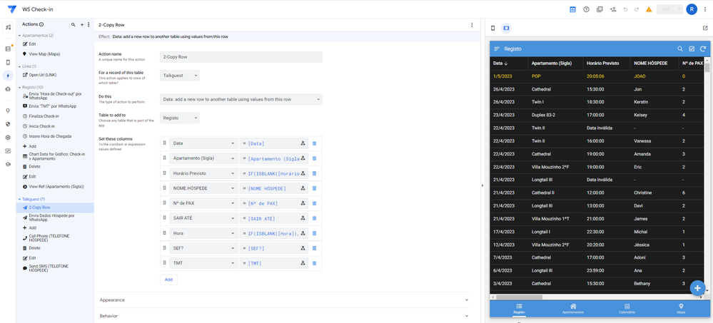

 2) I have another sheet with the same pattern. Is it possible to copy data from this other sheet to my main sheet, overwriting an existing line? To prevent me from losing this formatting and formulas? (I created an Action: "Data: add a new row to another table using values from this row", that works well, but it creates the new row exactly like the image above.
The action "copy data"The action "copy data"

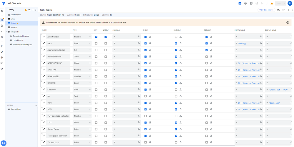

I've already tried changing the "formula" or "initial value" in the Data table in AppSheet, but it doesn't add the formulas to the new rows.
It is recommended that your data source backend is just a plain store of data. Stop using formulas in your sheets, set it all up in the app. A spreadsheet formula of =if($C2="-";"-";) can easily be converted to an Appsheet expression to put into Initial Value... IF( [col2]="-" , "-","")     (*kind of a pointless formula if you ask me though*).
I think you mostly just need to learn more about how appsheet works, and then you'll see that what you're wanting to do is not what you should be doing.
This post also seems like a bit of an "XY problem". As in you've seemingly already decided how you think you should solve your issues, Y solves X, and so you've asked us how to do Y. But what you should be doing is stepping back and asking us how to solve X.

2)As I said in my last post, I tried the formula in the Initial Value, but it doesn't work. Did i do something wrong?
Another recommendation: if you're going to build an Appsheet app, don't allow anyone to directly access the GSheet. Trying to accommodate both is a bad idea.
I don't know if you did something wrong, your initial value expression is not visible in your screenshot.
