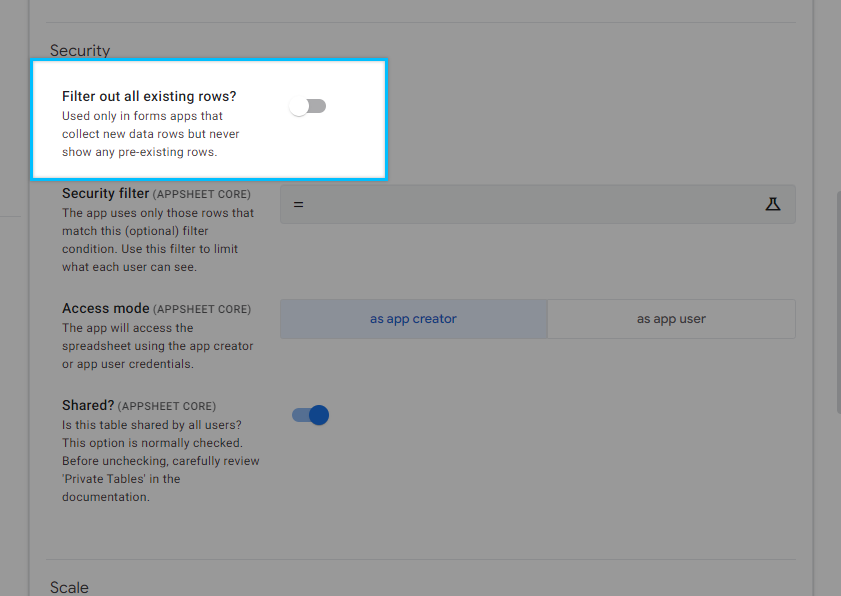

If you just want people to be able to submit data through you app, there's a toggle you can turn on (at the TABLE level) to filter out all existing rows:
d6a90073-8c6c-4e88-ae2f-ce0e3a43435f
