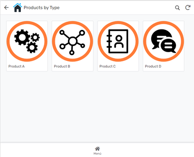

I have a Menu type Gallery with an Action to go to a Filtered view of the same table.
  • Button(icon) 1: Show product type A
  • Button(icon) 2: Show product type B
  • Button(icon) 3: Show product type C
  • etc

1. I have a Main Menu
2. This is the action on the behavior section of the gallery view: Menu
3. This is the formula of the action
4. If I click on the "product by type" icon of the main menu, goes to this view

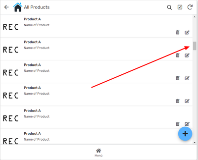

5. Then, I Choose to see only the products with type A and make scroll down
6. Go back with the back arrow or pressing the main menรบ button above, an choose product B Icon
The Scroll starts at this position, doesnt refresh when a LINKTOFILTEREDVIEW Action goes to the same view.
This only occurs on mobile or tablet. In browser works fine
It sounds this is an intended behavior because the app tries to remember the position from the view where you were earlier, and because the LINKTOFILTEREDVIEW() opens the same view for every category. One workaround could be that you create a view for each of your categories, which though doesn't make any sense.

I think I understand the problem. Aleksi's answer is basically right, although I'm not sure it's intentional. The existing view is getting reused, and since it's only the filter condition that's changing, there is no explicit resetting of the scroll position. The difference between desktop and mobile is probably related to differences in how preexisting views are reused in desktop.
I'll file a bug for it and see if we can identify a simple fix.

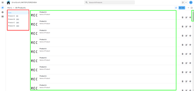

Another example is the following
On the same sample app I have the view "All Products" Grouped by Type
Here everything is fine.
But I work a lot with actions with LINKTOFILTEREDVIEW expression to make quick filters of the same table that saves a lot of time, so I have the button with the "@" on the top of the previous screenshot configured to show me only the products of type A. When I click it, happens the following:
The scroll bar is larger becaus it's only showing up the products of type A - โœ…
The list of products, only shows the products of type A - โœ…
The grouped section shows the count of all types of products that aren't shown on the current view - โŒ
If i click on the refresh button, then it shows all the information perfectly right
On the contrary of the other problem, this doesn't work fine on desktop, but works properly on device.
I Think that when anyone uses the LINKTOFILTEREDVIEW Function, should force a refresh of the table/view or whatever is necesary
