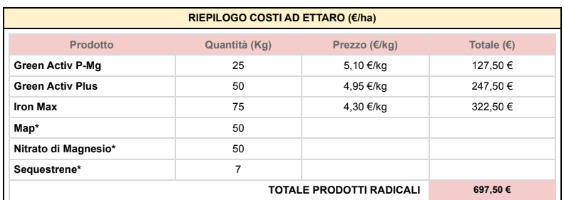

Basically I'm in this situation:
FERTILIZATION PLANS parent table
INTERVENTIONS child table
columns:
[ID] UNIQUEID column
[PRODUCT] reference to the product table
[DOSAGE] numeric column that expresses the quantity
[PRODUCT_SUM] numeric column that sums all the quantities of that product used in the fertilization plan.

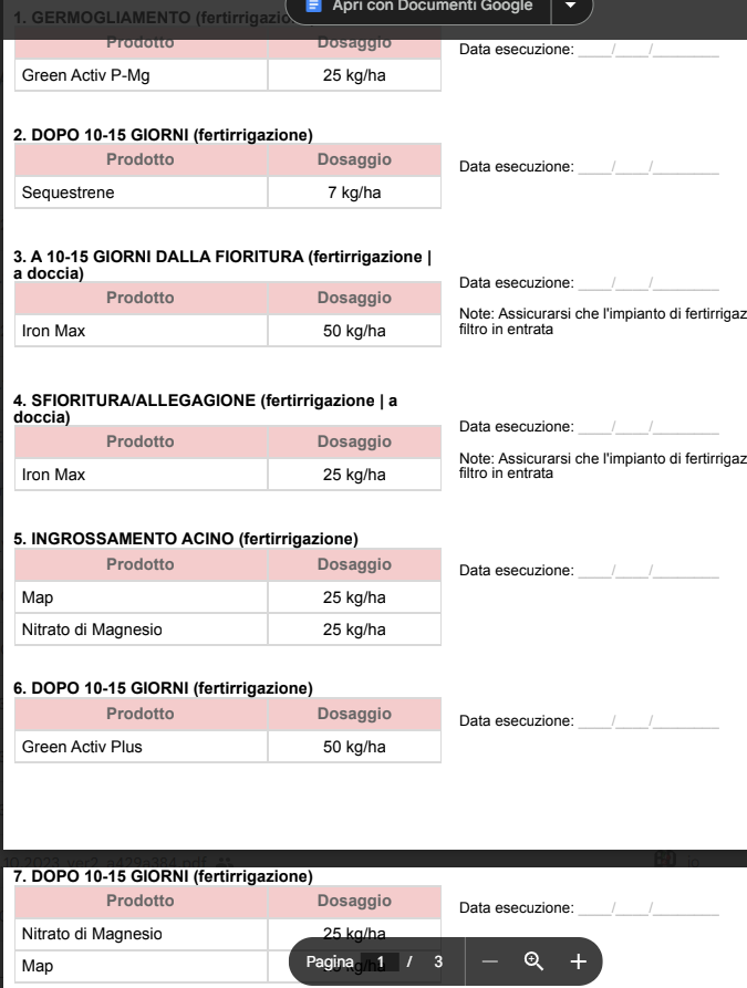

I built a PRINT PLAN table
with column [ID_PLAN] of type ref to the FERTILIZATION PLANS table
with a Bot that creates the PDF of the fertilization plan with all the intervention lines and related dosages.
At the end of the template I have to create a summary table where there are:
1. list of products used without duplicates
2. for each product the sum of all the [DOSAGE] values โ€‹โ€‹of the fertilization plan
So I thought I would get a unique list of INTERVENTIONS[ID] where I already have [PRODUCT] and [PRODUCT_SUM].
I just don't know how to get a unique value based on the [PRODUCT] value.
I have to get something like this:
Summary to getSummary to get
INTERVENTIONS recordINTERVENTIONS record
Maybe I'm taking the wrong approach...

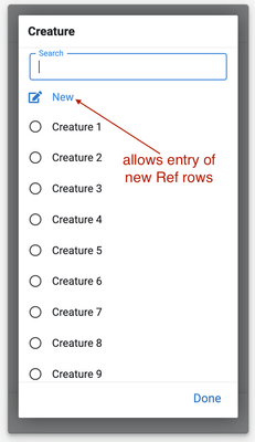

For any NEW entries of "Possible Interventions", new products or for different Dosages (if allowed), you would have the user do this from the dropdown list of "Possible Interventions".  You can configure it to show a NEW button to add these new rows.  See image.
