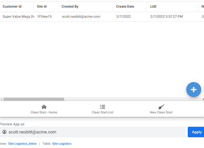

I have a main record page that looks like this and allows the user to either edit main (Clean Start) record or add/edit one of the sub-records:
When I click on one of the icons it takes me to a sub page like this:
However, when I click on the + to create a new record I do not have access to the main record key, Customer Id.  Any suggestions on the best way to resolve this?  Perhaps stuff the key in the UX somehow? (At least, that is what I would do if there were a real webpage.)

Yes, for my Site Logistics sub-table I have a Customer Id reference to the main table.  When I say I don't have access, I mean that in the create new Site Logistics action I don't have access to the parent key (have to hard-code this to work):  LINKTOFORM("Site Logistics_Form", "Customer Id", "f4d8447d")  Here is the top part of the sub record:

This is how I get to the inline view: LINKTOFILTEREDVIEW(Site Logistics_Inline, [Customer Id] = [_THISROW].[Customer Id])

Just tried that, no luck.  The icon does not even show up, indicating that the Customer Id value is not valid.  This actually makes sense since there is no Site Logistics row yet.  ๐Ÿ˜ž
So the question becomes: Can table view of sub-records have access to the reference to the main record?  If not, I don't see how to create new sub-records with the correct link in this kind of view.

Actually, this issue is resolved.  I just had to use the LINKTOFILTEREDVIEW() the way HBT suggested and use the default add record icon.  Thanks for your help.

Ah, that did it!  Thank you so much, HBT!  (For reference, I was trying to create a custom add icon and that does _not_work.  For some reason, only the system generated add action created the correct link.)  Thanks again, was stuck on that for three days.
