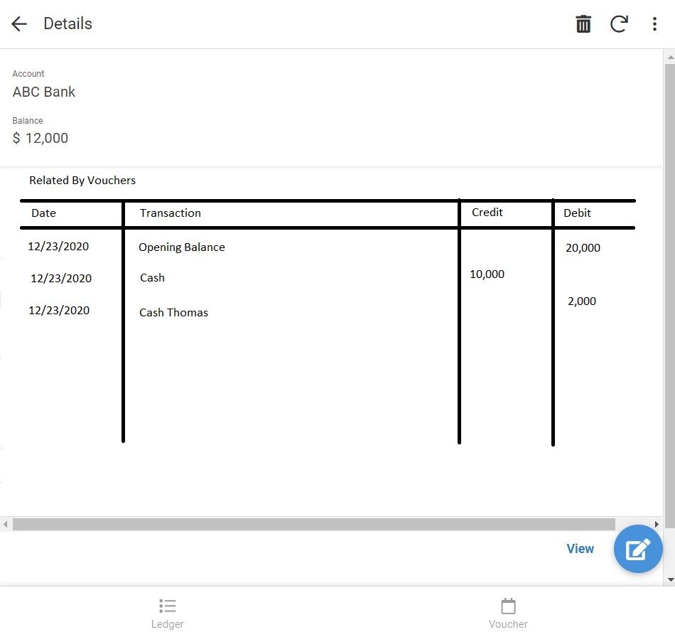

Ledger with two ref rows amount to credit and debit transection
Current Setup & output of results in 3 images Below:
Result I require in reference list as shown in image below:
0 3 519
Since you’ve already got things split out into separate Ref_Rows(), you could simply hide those and use list addition to combine them together into one; then hide the original two and only show the combination.
Thanks it solved one of my issue of combining two ref rows.
But is it possible to make this kind of relation with ledger as shown in edited image?
or i have to approach with different kind of idea or set of tables to achieve my required result?
It looks like you’ve got your credit and debit entries separated out into table; if you combined them together into one, with a [Transaction_Type] column, then you wouldn’t have to have things split up like this.
But if you’re wanting to keep things has you have them, what you need to do is create a “Display” virtual column - to serve as the label.
IF(isnotblank([Credit_Ref]),
  [Credit_Ref].[Name],
[Debit_Ref].[Name)
This way, no matter what type of transaction something is, there is a unified field you can show that functions as the label.
(Oh, and mark this virtual column as the label for that row too. )
