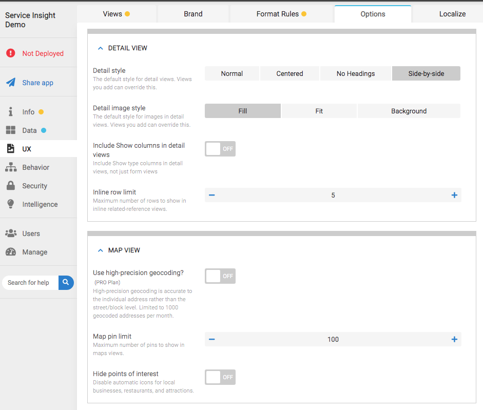

You can control the size of groupings in your map view under the View Options section. See the image below for an example. It might also be worth mentioning that you can control the pin count on the map by going to UX -> Options -> Map View -> Map Pin Limit
Use Minimum Cluster Size to control Groupings
Use Map Pin Limit to control number of pins shown
