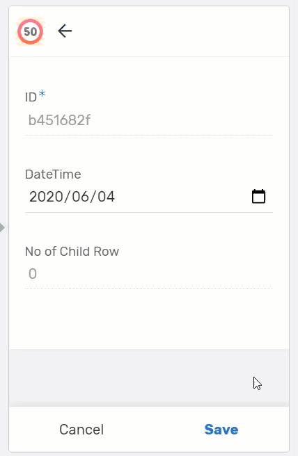

Im taking different approach when i want to limit the number of child row to be added to one parent.
First, to make the inline child view set to parent table out of slice which is update, delete only (not able to add.)
Make a virtual column to parent table to dynamically calculate the number of child rows.
Make action attahced to parent table, which will open the form to add to it child table.
The action button is made visible only when this Virtula column value is less than and equal N.
For this quick demo, i set app that the user can add max 3 rows to child per parent record.
