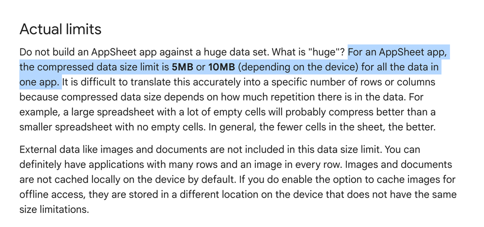

Hi John. I was not aware of this limit. Is there a comment on this in the docs? What does it refer to?
@WillowMobileSys
It's not documented more than that and for app creators it's impossible to calculate.
Below is the excerpt from this article.  I mis-stated that its for both app + data.  I also believe these limits are outdated.  Today's devices allow much larger apps and data limits.
