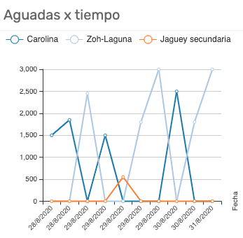

I´m trying to build a line graph (series), but I cant match the results I need.
So I have this table, generated from a form that measures water levels from different ponds at different time. (It´s an engaging community wildlife monitoring project, so anyone will be able to report at anytime on any WaterPond)
I need to build a line graph which has the water level (y) of the different ponds (series), over time (x).
3X_b_9_b9f0bb66ed3d82168b936f9eb6e2187b559d9481.png 3X_e_1_e1bb273ccd107aaba671a648c9ef2975c55e7e98.png
I´ve tried using this data but it shows only one line (series) with all the events where waterlevel was measured, but it doesnt differentiate between WaterPonds.
I believe the way I structured the form wont allow me to do this, so I restructured the data on a new table on GSheets like this using vlookup:
3X_a_5_a5072905c032c813bcf074b46455f28a91027150.png 3X_d_4_d4456a10e4764cade92b2876f0a9390c3972a8d2.png
One problem is solved, I have different Series for each waterpond.
The problem now is that each event carries a N/A or “0” result for the ponds that were not measured at that same time.
This means that for each date or event, I get 3 values: one correct number for the pond measured, and two zeros for those that weren´t measured
Meaning that the series drops to zero those days that the pond wasnt measured.
Im stuck here now, and Im pretty sure Im overthinking this and there´s an easy solution for this…
I hope someone has an idea that can help me unlock this thing.
Thanks for reading!

I Tried to have the water activity of different production lines overlayed onto the same chart, this is as good as I could get it.
Hoping the solution to this thread will help me. Thousands of entries on this chart.

If I may add, as per my understanding you may either have
  1. Three independent charts for each pond, so any days when readings are missing are eliminated by way of creating slices. You could then base one each chart for each pond based on those slices.
  2. For a combined chart, when the reading is missing for a pond on a day, the chart line will naturally default to zero. So you could build some logic such as if the reading is missing on a day for a pond , the latest previous reading is considered in place of zero or #N/A . However I believe this logic will be somewhat complex and will include MAX() or MAXROW() etc. if implemented through AppSheet.

Your option 2:
build some logic such as if the reading is missing on a day for a pond, the latest previous reading is considered in place of zero or #N/A
I like this idea, will work on the formula and let you know the results.
