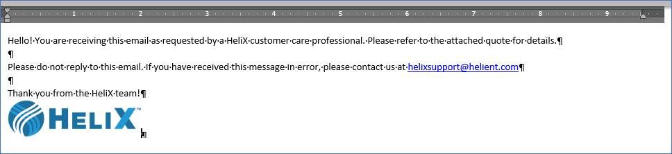

Here is my template in Web Layout view with paragraph marks visible so you can see all my CRโ€™s:
For this one, GMail in Chrome actually looks perfect:
Outlook Web (in Chrome) and Outlook on iOS both look like this - notice the incorrect wrap after โ€œPleaseโ€ and again after โ€œmessageโ€:
Outlook 365 on Windows 10 has no line wrapping issues but notice the logo is almost double the size:

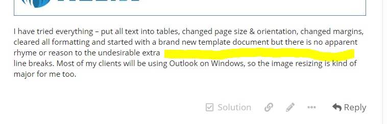

I have tried everything โ€“ put all text into tables, changed page size & orientation, changed margins, cleared all formatting and started with a brand new template document but there is no apparent rhyme or reason to the undesirable extra
line breaks. Most of my clients will be using Outlook on Windows, so the image resizing is kind of major for me too.

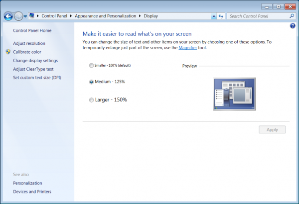

OK, so I have done a great deal more research on the inline image sizing issue and I believe it is because of the way the email body templates are converted to HTML format. Yes, the issue seems to only present in Outlook, but the fix is on AppSheetโ€™s side of the court as far as I can tell. In a nutshell, the issue stems from the way that Outlook handles (or mishandles) DPI scaling. There are two options it seems: 1) insert MS Office specific headers and tags into the HTML or 2) convert inline images to a fixed size in pixels instead of using inches.
Examples of Option 1 abound on the nets by Googling โ€œOutlook dpi scalingโ€. Here are a few:
Option 2 is just the result of me testing the composition of an email using Gmail. Regardless of the dpi/ppi setting in the source image, Gmail scales it automatically and inserts it into the HTML using a pixel value.
