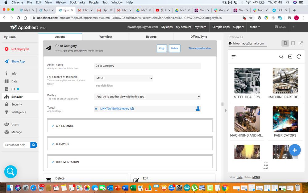

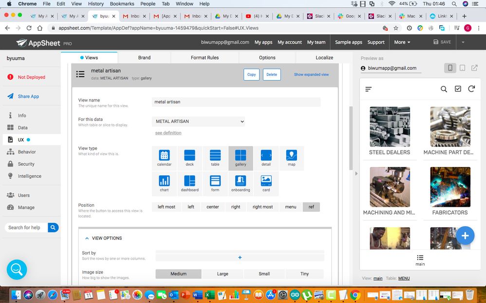

Please post screenshots of the following:
  1. The action configuration.
  2. The entire Target expression for that action.
  3. The configuration of the view in which you want to use the action.
there they are
The action and the view must both be attached to the same table, or the view attached to a slice that sits atop the same table. Try attaching the action to the METAL ARTISAN table, then configure the view event.
I did this but it was giving me the same problem
This is my input:
If you have checked it all, you should be seeing the event actions when clicking the auto of the Row selected dropdown.
