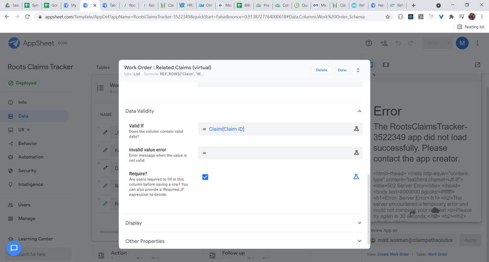

I have a table that is a list of Claims. Medical claims. I also have another table called Work Orders. I need to put in a Work Order and select multiple claims when I do so. The Claims table has a reference to Work Order. One Work Order can have multiple Claims. This automatically generated a list of REF_ROWS in my Work Order table, referencing the Claims.
Naturally, in the form, I would expect there to be a dropdown of Claims I can select when I’m creating my Work Order. I’ve created the form and there are no dropdowns. I’ve even tried to explicitly add the columns but they still don’t appear even when I add them.

I actually broke the application! I saw that I could mark the field required before saving the row. Someone has to select at least one claim to save the Work Order. Surely, surely, I would be forced into presenting a dropdown, because this column has to have a value to be saved! But nope, the app decided to not work all together, rather than provide me a dropdown.
