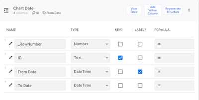

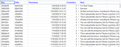

Thank you.  So here is what I am working with...
Table 1 - Data...
Table 2 - Selection
I have been following the model here to setup a view table filtered by a dynamic user defined Date range... https://www.appsheet.com/templates/Allow-the-user-to-filter-a-view-based-on-a-form?appGuidString=912...

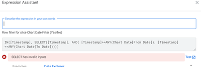

Thanks so much for chiming in Graham!. I just gave it a whirl and received this:
As you can see from my table screenshots, the Datetime format is applied to all 3 columns, so not sure what is causing this.
Yeah sorry, I wasn't thinking. Even though the Chart Date table only has one row, it is still considered a list. I think the revision I posted below should work.

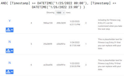

OK, let's do a little investigation here, can you try hard coding a date range in an expression and testing to see if the rows are filtered at all, something like this:
AND(
  [Timestamp] >= DATETIME("1/1/2022 00:00"),
  [Timestamp] <= DATETIME("1/21/2022 23:00")
If this doesn't filter then it means either my logic is wrong, or somehow the [Timestamp] column is not containing the data we think it is. Of this does work then we can look at the Chart Date table.
I don't know why I didn't think of that Graham. You logic is solid, yet still not filtering:
I really don't know why!

Apologies for being unclear. I was saying that even though the editor like your expression code (both hardcoded and not), the records are still not filtering by date on the test page or anywhere, even with hardcode.
In my screen captures above, you will see that, even though I selected a date range from 1/25/22 - To 1/26/22, All records are still showing on test page, including the one you can see on the snap from 1/22/2022.
In my mind, this should be working. Any idea why the records won't filter on the test page, even with your amazing and efficient expression code?

Almost there I think, try this
IN(
  [Timestamp],
  SELECT(
    Entry Log[Timestamp],
    AND(
      [Timestamp] >= ANY(Chart Date[From Date]),
      [Timestamp] <= ANY(Chart Date[To Date])
Thank you.  It didn't error out, and it seems like the data is not filtering, Here were my next steps:
  1. I created a Form view for the Chart Date filter table to edit the from-to dates.
  2. I tested it to make sure that it updates the Chart Date Table and it does create a NEW row on each save (Having more than 1 from-to date record seems potentially problematic???)
  3. Then, I created a chart view of the data slice based on Entry Log Data Table, that shows a histogram of AVERAGE of Evaluation numbers and a Results table view for testing.
  4. Lastly, I created a dashboard view. I was able to include the chart and table view, but not my Date input form, so for testing, I just opened up my Date input form separately and made an entry.
I made sure I had a valid from /to dates on only1 row in my Chart Date Table on the back end, and everything looed good. However, the chart and results table are not being filtered in the dashboard \, and without any errors?

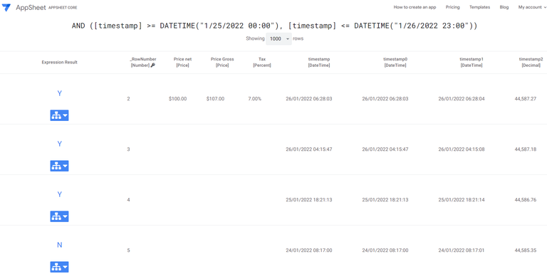

Perusing this issue and from experience, I see the same issues I had and which are not well documented and all relate to the date format used. To sho wthis I created 4 different timestamps using different formats as shown below in google sheets
The first uses the same format used here. The second is the same format but converted to number and as may be seen there is no change. The format used is m/d/yyyy h:m:ss
The third is the normal format used by most SQL databases namely  yyyy-mm-dd HH:mm:ss
and the fourth is the same as the third but converted to a decimal number and as may be seen it returns the actual DateTime as a decimal number which is the true underlying number representation.
What this shows that at the surface level the format used appears normal but when used in queries the format prevents the underlying number from being used and rather an unknown text date is used.
This does not apply when using the format I have shown as the underlying decimal number date representation is readily available.
This seems silly but it can cause one to tear one's hair out simply because APPSHEET conforms to the normal database type number and ISO versions of the date and this is neither well-known nor documented and what led to the head bashing exercise above and a seeming solution.
Now creating a virtual column and doing and using the same formula I get
AND ([timestamp] >= DATETIME("1/25/2022 00:00"), [timestamp] <= DATETIME("1/26/2022 23:00"))
and this works for all time stamps but not for timestamp2 which is decimal and gives the following error
In your case you are using dates obtained from another source whereas the above used the DATETIME FUNCTION to correctly convert the used format to the correct internal time that APSHEET understands.
This suggests that your From Date and To-Date format is incorrect.
You should ensure that the format of Timestamp, From_Date and To_Date are identical both at spreadsheet and APPSHEET column type as APPSHEET uses its date representation which is normally ISO-8601.
